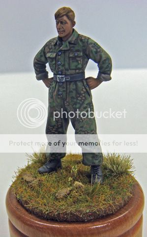

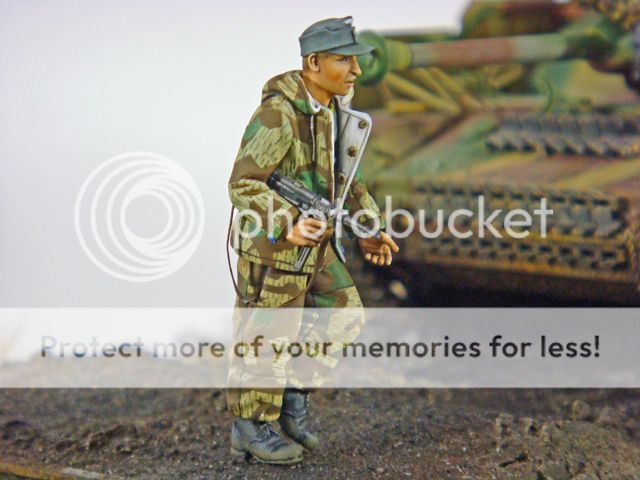

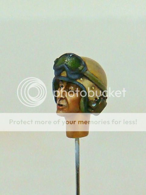

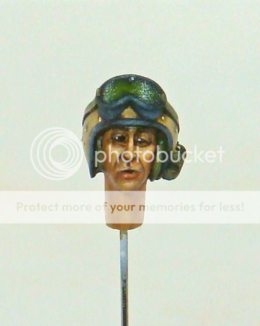

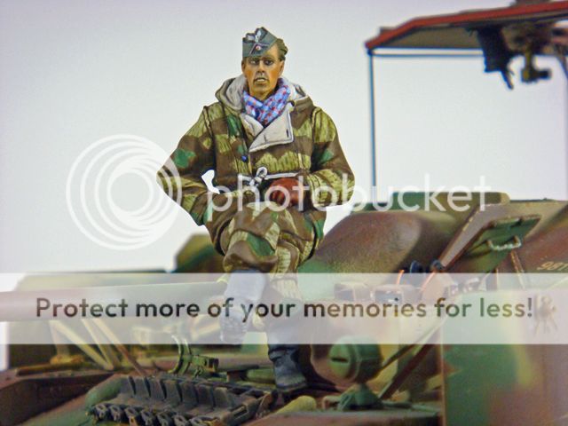

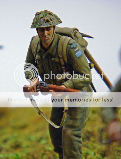

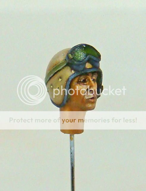

Here're some "happy snaps" of 1/35th scale figures that I've painted, all with artist oils over acrylics:
(I just started this Israeli Tanker this afternoon for practice. It's still wet and has a little work to be done yet...)
