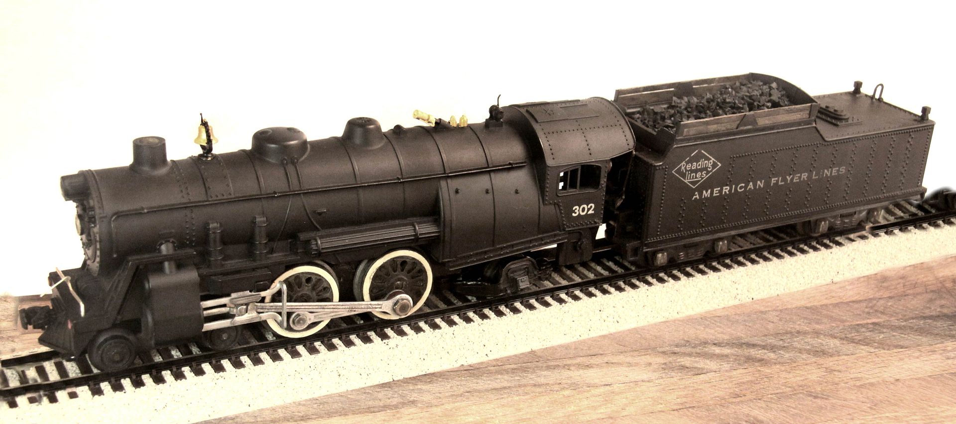

I received this freight train set for Christmas way back in 1956 when I was seven. As the years went by I became more and more interested in SCALE models of all kinds. I lost interest in the "toy" trains and this locomotive got relegated to the attic where it waited patiently for me until once again I returned to the roots of my hobby.
I have since come to the realization there is plenty of room in this hobby for all sorts of scales and all sorts of subjects. I had been thinking for a long time that there were perhaps hidden possibilities in this otherwise rather plain and, for the day, inexpensive locomotive offered by American Flyer.
165thspc
#521
Joined: April 13, 2011
KitMaker: 9,465 posts
Posted: Sunday, November 18, 2018 - 09:33 AM UTC
I basically did anything and everything I could think of to enhance this simple, classic model locomotive short of grinding off existing molded on details.
- Brass Bell
- Brass Whistle and Pop Valves
- Steam Driven Electrical Generator - added brass casting
- Front pilot coupler
- Colorful Number Board with decal numerals
- Coupler Lift Bar
- Green Marker Light Jewels
- Red painted Coupler Pockets
165thspc
#521
Posted: Sunday, November 18, 2018 - 09:50 AM UTC
And then to the tender:
- Higher Coal Bunker Slope Sheet
- Wooden Bunker Sideboards
- Slope Sheet Supports and Ladder
- Rear Marker Lights with red jewels
- Rear Ladder Top Loop
- Rear Numerals
- Lengthened Tender **
- Wooden Shovel Deck Bunker Boards
- Realistic Coal Load
- Shovel and Broom added to tender shovel deck.
- Tender Brake Cylinder
165thspc
#521
Posted: Sunday, November 18, 2018 - 10:06 AM UTC
** I continued to use the original metal chassis from the old Flyer sheet tin tender but it was too long for the new plastic tender shell that I wanted to use. The tender you see here is actually two of the AF plastic tenders spliced together.
I cut the two tenders at the last row of double rivets to help hide the joint and ended up adding approximately 3/4 inch to the length of this new combined tender shell.
165thspc
#521
Posted: Sunday, November 18, 2018 - 10:17 AM UTC
I added some flooring to the cab and also a rear buffer plate to the engine to fill in all that very visible open air space back there. Finally I added the cast metal trailing truck frame to the rear pony wheel. (Available from Port Lines Hobbies)
In my mind this last small change really constitutes the crowning touch to the entire conversion.
165thspc
#521
Posted: Sunday, November 18, 2018 - 01:40 PM UTC
Here is the classic "before" shot of my original, unaltered 1950's Flyer locomotive, ugly (IMHO) sheet metal tin tender and all!
At this point the only thing that has been done was the addition of the bolt-on, cast metal side frames to the trailing truck.
165thspc
#521
Posted: Sunday, November 18, 2018 - 02:06 PM UTC
And here is the train my childhood locomotive is intended to pull. My turn of the century 1900's era passenger train.
I admit I use those dates rather loosely (The cars are more 1890 and the locomotive more like 1910) but still I think it makes for a nice combo.
p.s. That shorty, single door baggage car - top left - is another of my custom creations.)

Just a little more discussion regarding that very nice after market cast metal rear trailing truck frame. It is suitable for almost all American Flyer locomotives having a single axle trailing truck. (I even put one on my streamlined "Royal Blue" locomotive!) It installs with just a screwdriver!
Again it is available online from a company called Port Line Hobbies,
Port Lines' website can be found at:
http://64.251.10.24/~worldofw/cgi-bin/shopplcom.pl/SID=415479/page=index2-new.html
The trailing truck is item number #1966 in their catalog.
