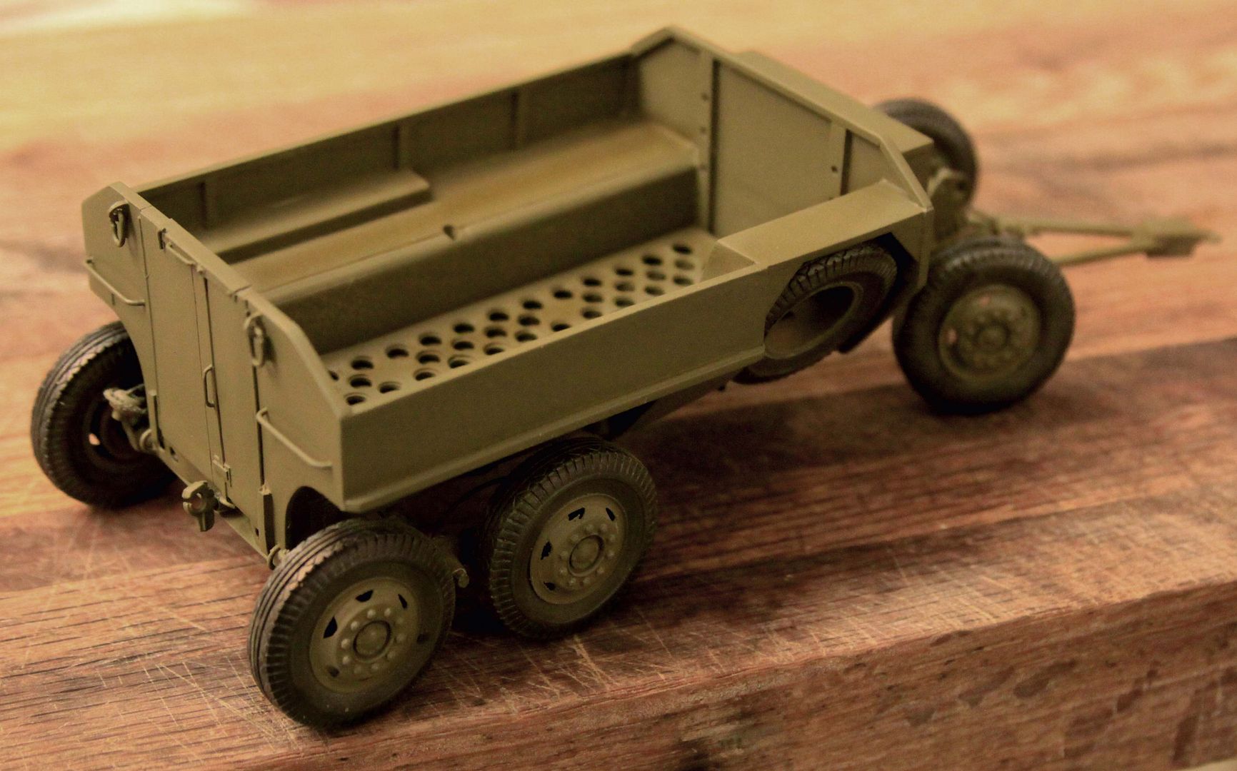

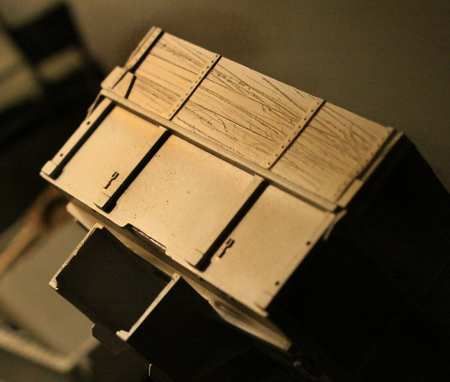

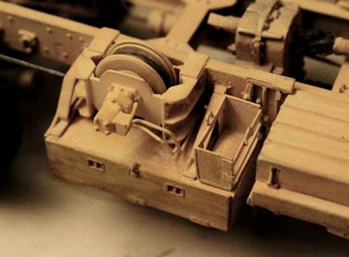

Not saying what followis is the total answer - it's just what I do - I post it here just as an inexpensive idea starter:
I use a home bathroom as my "soft box".
It's small, all white and has a big mirror and six big make-up style lights for illumination.
When shooting I borrow the big cutting board from my kitchen to use as a stage and use 2 sheets of taped together typing paper supported by a handy spray bottle for a back drop.
Sometimes I do use a small hand held light to add some high lights to the subject.
________________________________
Some of the many photos made with this make shift bathroom sized soft box:

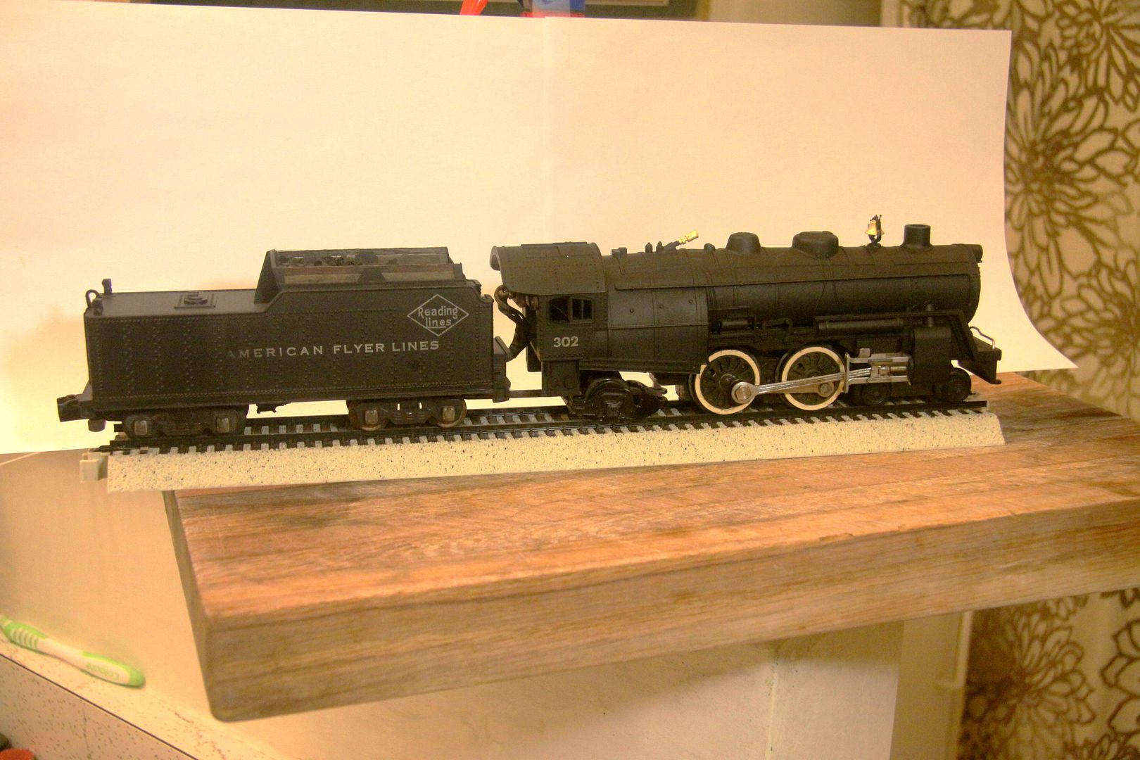

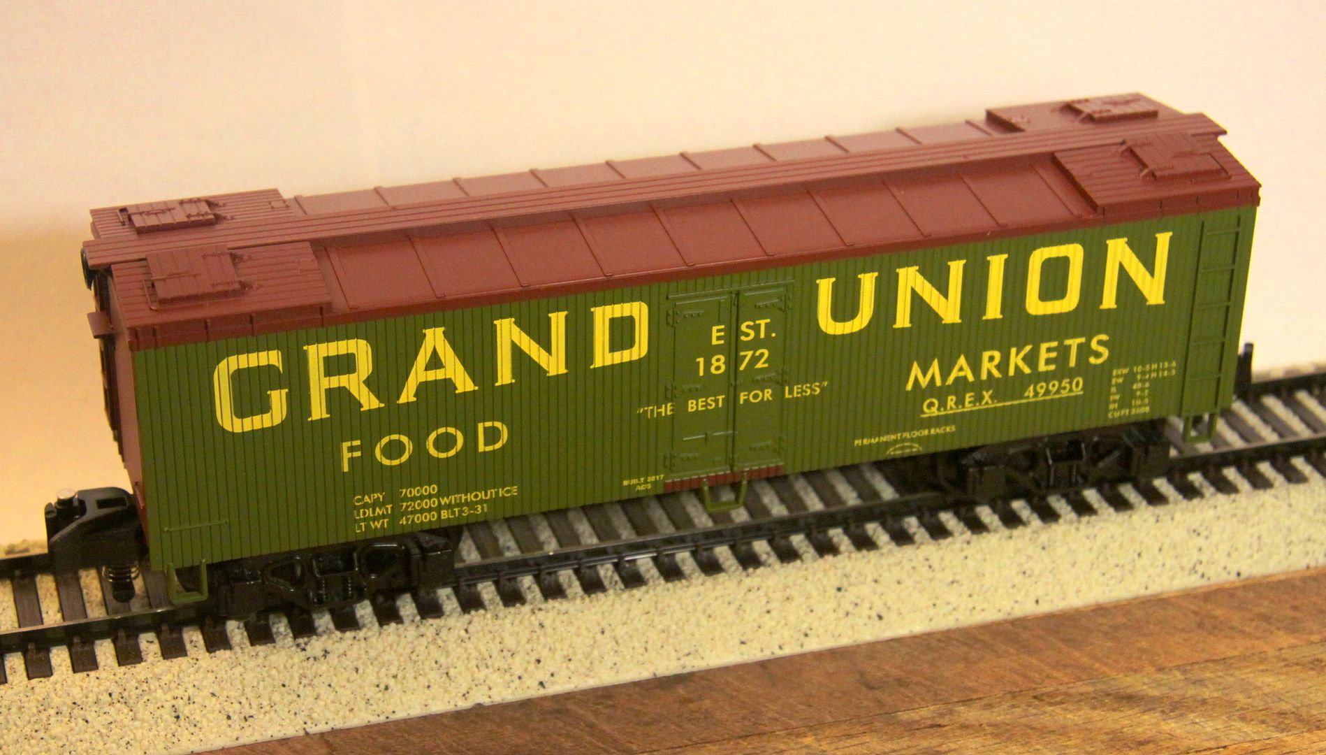

Posted: Sunday, October 20, 2019 - 01:48 PM UTC
This arrangement seems to work well on close ups too.
Do try to rig some sort of support to act as a tripod or steady rest for your phone/camera. Just leaning an elbow against a wall while taking the picture can help sharpen your photos considerably.
Even a child's simple bean bag toy placed on top of an inexpensive camera tripod can make for a nice steady rest to support your camera phone.
