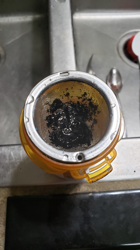

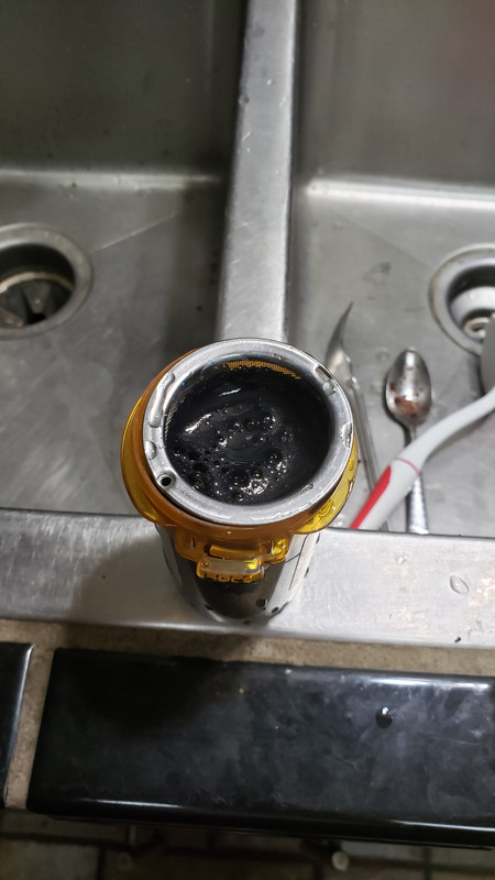

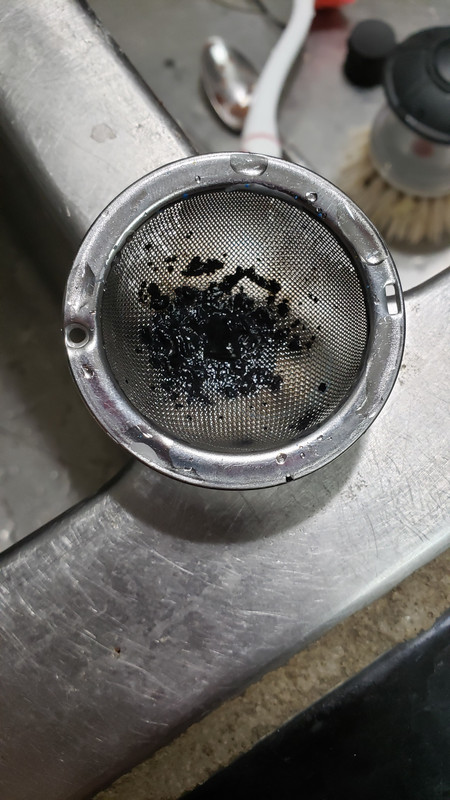

Wanted to post this as a FYI mainly. I dont want to slam the brand as maybe this is a an issue from somewhere in the supply chain. This is happening to a major portion of my 17ml and 200ml size bottles. I have well over 125 bottles all bought from the same store of the last two years. Bottles purchased in the last month are also having this issue. I would say over 50% of my paints have this issue.
Long story short, I would highly recommend straining your paints even if just using a small amount in the airbrush. I drove myself nuts for months wondering why my brush was acting so different many times.

yes, done with using a shaker. The clumps are dried paint, and are in new and old stock from the hobby store. Straining works, but might switch to a different brand every time I run out of a color. I have a brand I will switch to. But I dont want this to be about being pro or con on any brand.

So about 90% of my paint is Vallejo air. But this happens really bad with Vallejo primer paints the most. From this source. Both black and white have been extremely bad. The pics are Vallejo black primer 200ml. Not having this issue with Vallejo model color from hobby lobby. I might switch over to Mission models. But my paint racks fit 17ml bottles. I also have some tamiya and have had no issues.
None of my bottle are more than 3 years old. All are stored in home temperature controlled now.
Anyway, where I went wrong is just assuming all purchased paint is good and ready to go in the airbrush. Just saying, strain it and you might be surprised.

wow, okay lots of good info going on here.
i do want to say I am not trying to slam vallejo. I still use and will use all of what I have from them. Although I have thrown some away because of to much decay going on in them from the ball bearing issue.
Obviously most paint booth guys filter all the paints they use before shooting. not sure why I took it for granted and assumed I didnt have to. Looking back, just the way the paint drys around the tip of the 17ml bottles just screams future clog issues, but my bad.
This issue killed three iwata neo brushes for me. Again my bad. But if you ever have had this happen to you you know how seriously small the tiny little rubber balls get. They are smaller than the screen in the pics alot of the time. man this really made me dread paint time. It was sucking all the enjoyment out of the hobby. Now that its figured out, I am building like crazy.
